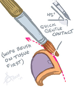

* To wrap things up, I'd put on some thin edge highlights. A fine top brush is nice, but you don't always need one. I have some cheap ones about as fine as a heavily used used toothpick. I don't paint with the tip. Instead I wipe out some of the paint on a tissue, and woosh over the edge like this. It's not like drybrushing, where you wipe out nearly all paint and fly all over the place with the brush.
