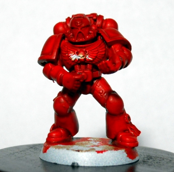

This main picture, what did you use on it?

I described what I used on the pic model, but I'll go into more detail. =) :
Primer: Rustoleum Painters Touch 2x Grey Primer
Paint: Krylon Fusion Made for Plastic Spray Paint Bright Red
Wash: Games Workshop Gryphon Sepia.
I primed it, waited for the primer dry(about 5 minutes), gave it two very LIGHT! coats of Krylon Fusion Red.Its really easy to mess up and overload on spray paint. The trick is to spray left to right with the can at least 12inches from the mini and spray in bursts. I let it dry overnight, although it was ready to the touch after about 30 minutes. Once it was dry I just washed it with Gryphon Sepia. Not even a matte coat or anything. Its more of a Blood Raven red than Blood Angels but I'm sure Blood Red could be easily layered on to achieve the desired tone.
Here is my post on my personal blog with all the shots in sequence
