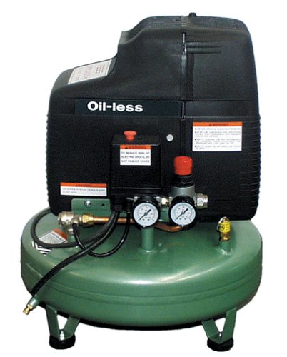

Thanks for the input guys, ive been viewing the air sources online and ive looked at cheaper ones like this:
http://www.tcpglobal.com/airbrushdepot/50204.aspx
Someone mentioned using a regular homeowners compress, however the cheapest ones online I could find were around 90 dollars. Two questions concerning this, A) Does anyone know of cheaper ones that would work or B) If im going to spend 90 should I spend the extra 5 and just get the above mentioned linked one?

The advantage of an 'airbrush' compressor is that they tend to be quieter than a standard homeownders type compressor.
If you are not in a hurry, check out Sears and watch for closeouts on compressors (or if you have a Sears scratch & dent center nearby...)
I have an older compressor that I am using more & more that is only slighly louder than my old Badger compressor.
1/8hp airbrush compressors (in general)
Quiet.
Max at about 30-40 psi usable pressure.
Run constantly (unless you spring for a tanked one...)
1/2 hp commercial model (again in general):
let you run more tools than just an airbrush (stapler, nailer, air eraser)
noisier (some too loud to have in the room with you.)
cost more initially
let you paint fabric paints (generally you need 40-60 psi when painting shirts).

I spent more time today on the net researching compressors and I ran into this forum thread, I thought that it might be useful to others so here you go:
http://www.hobbyfanatics.com/index.php?/topic/1282-testors-mini-blue-compressor/
After reading this I think i might go with one of the compressors from walmart, I might go with the 1 gallon compressor for 55 instead of springing for the 2 gallon 100 dollar one unless someone see's that this would be a mistake. Im not worried about the noise as its going in the garage and I have earplugs and a loud radio :)
Ask them to plug it in for you before you buy it. It doesn't hurt to ask - especially if they already have one out as a floor model.
Noisy in the garage may mean you still have to shut down at 8:00 or 9:00 in the evening as your neighbors may not like the thing either if it is loud.
I've seen some of them you can stand next to and talk normally, and others you wouldn't want in the same neighborhood with you, let alone the same room.
